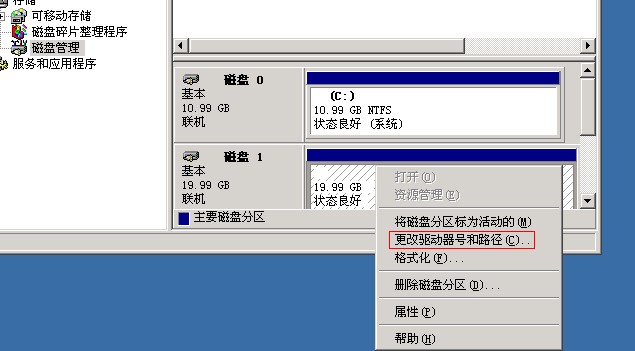

3. 更改磁盘驱动器号和路径
[attachimg=635,351]44[/attachimg]

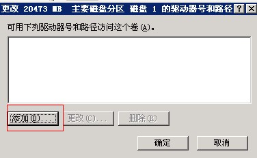

4.添加
[attachimg=376,231]45[/attachimg]

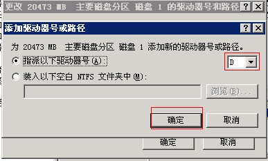

5.指派以下驱动器号:
[attachimg=387,233]46[/attachimg]
